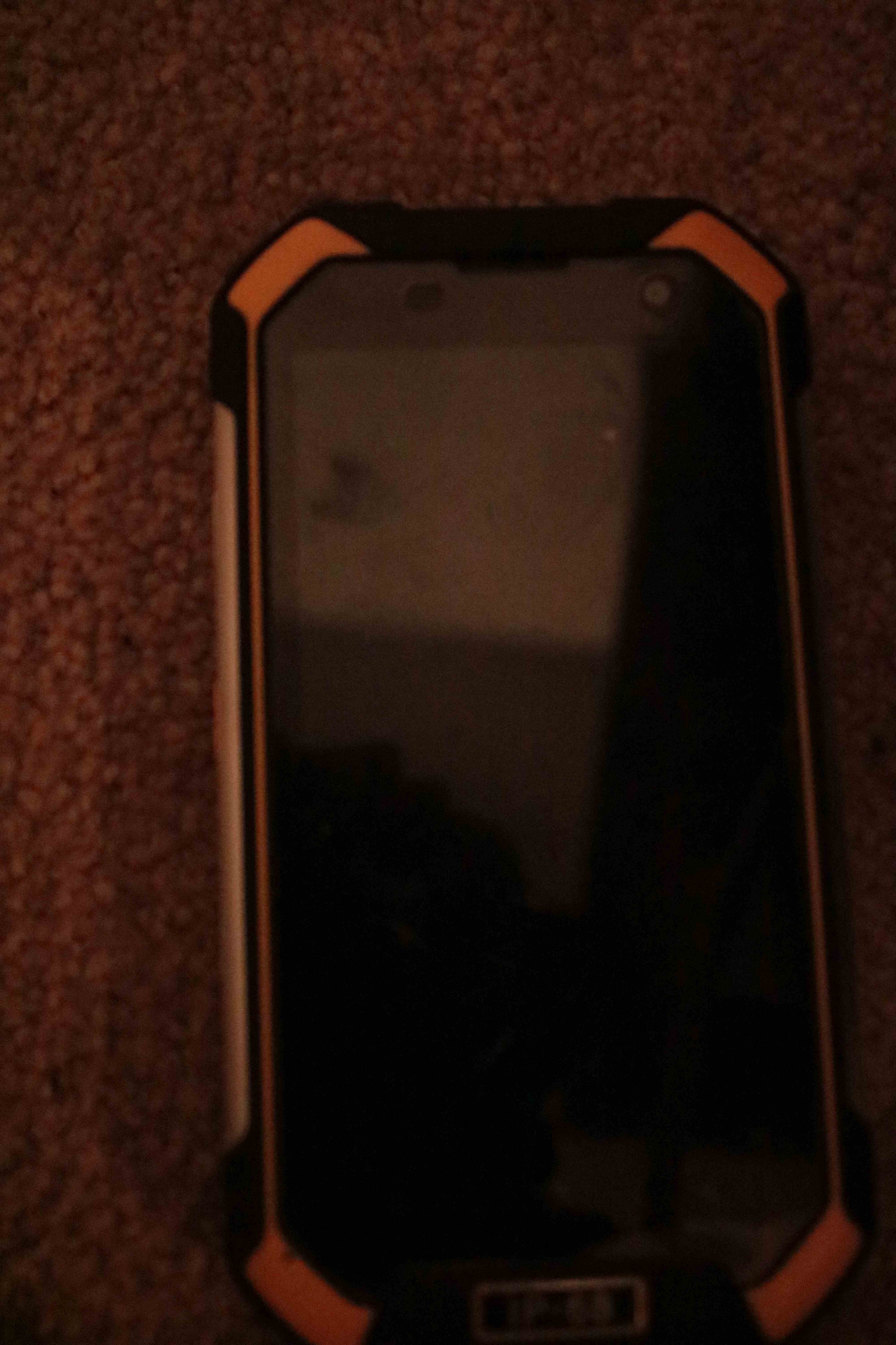

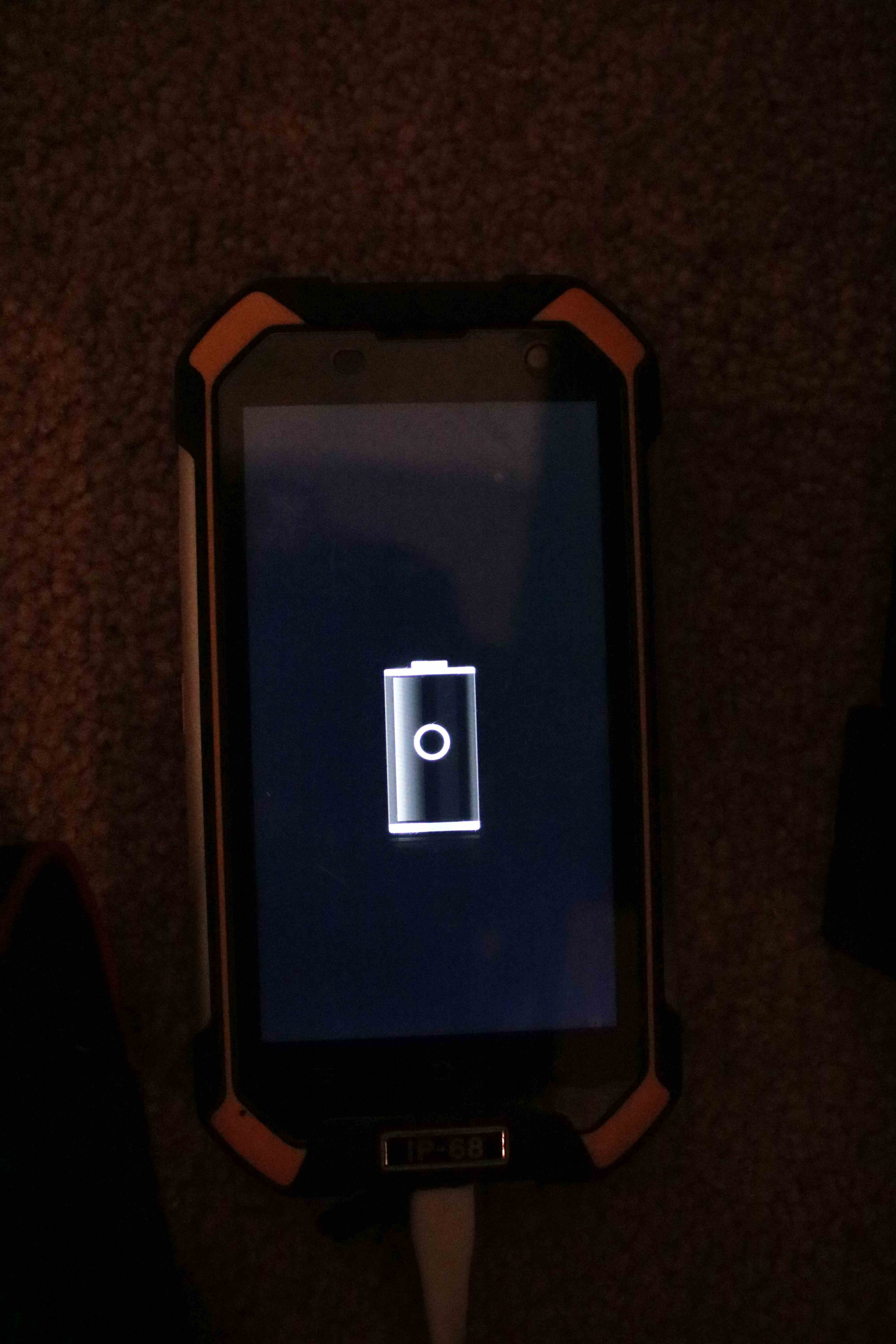

I currently have trouble getting to charge my BV6000 after it run out of Battery. So it was low on battery and turned itself of. Due to the Blackview Charger broke so I couldn't charge it up with the original one I tried to use a standart Usb charger und made it fit. But now the battery is not really charging. All that happens is that it changes inbetween two battery symbols (see pictures) every couple seconds. I've already ordered a new one but I'm trying to fix the issue because I need my phone working as quick as possible. Any suggestions or people with the same trouble?

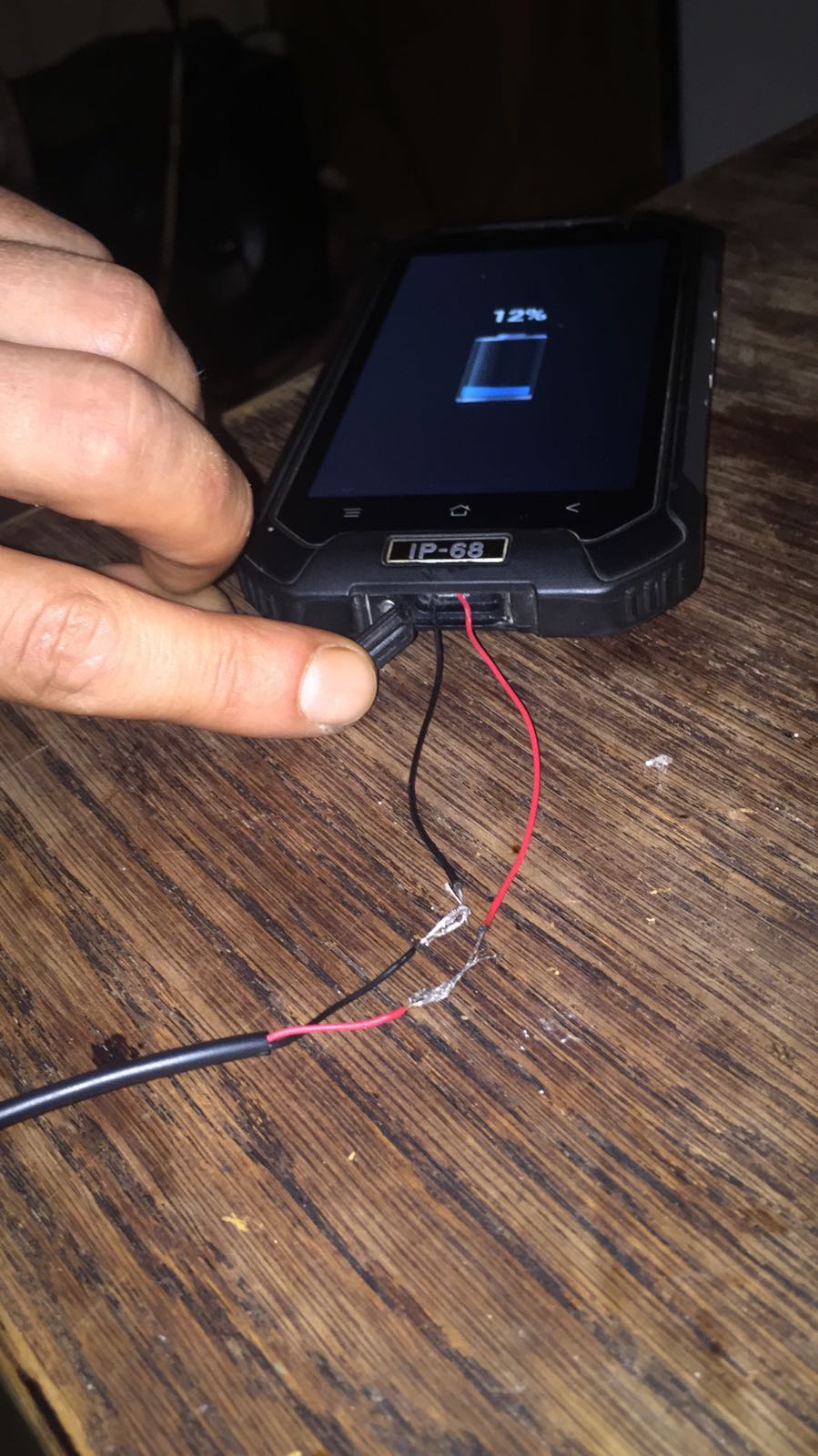

I had the same problem and blamed the cable or android updates, running on 6 now... Needing badly a phone/internet on a daily basis I've said to open it up to check when realised that the little plate inside the micro usb detached from 5 mini-weldings at the back! Well, I've searched online for complete mini pcb sub 2, the thing is only from China being delivered and...no microphone! :) but brand new...:D So I've ended up ataching wires as shown in the picture attached ;)
