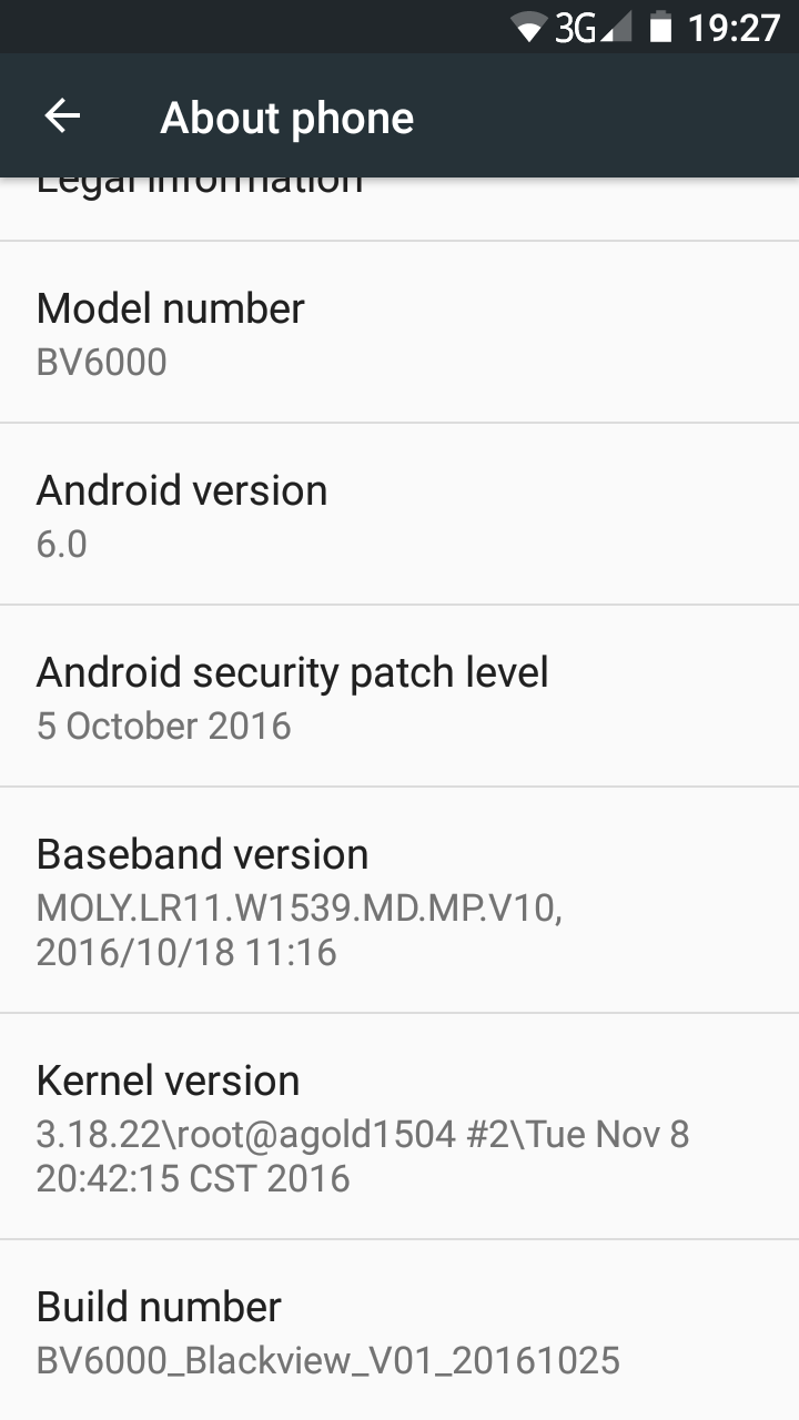

Have the same problem even tho mine can reboot on its own a minute or less before it fully boots. It also does it at any tkme with any charge. Running apps pr not. However i am running android 7. Alsp i noticed that before when i updated the apps i would have to restart the phome to get new updared for the apps. Now apparently i ahve to do that before i can upgrade after a new release. As of today the play store keeps doing the same update for twitter and facrbpok everytime i restart the phone.

You have a pretty old firmware, the answer you'll get from Blackview will be first to update to the latest firmware viewtopic.php?f=144&t=101183&start=40#p307071 and then check whether the problem has been solved or not
Re: BV6000 Randomly turns off
Mon Jun 19, 2017 8:15 am
Parcheval is right, please update to the lastest Version (viewtopic.php?f=144&t=101183#p284253) to solve this problem. You can upate Over the Air, by Local file or by flashing over PC (viewtopic.php?f=144&t=147109).
