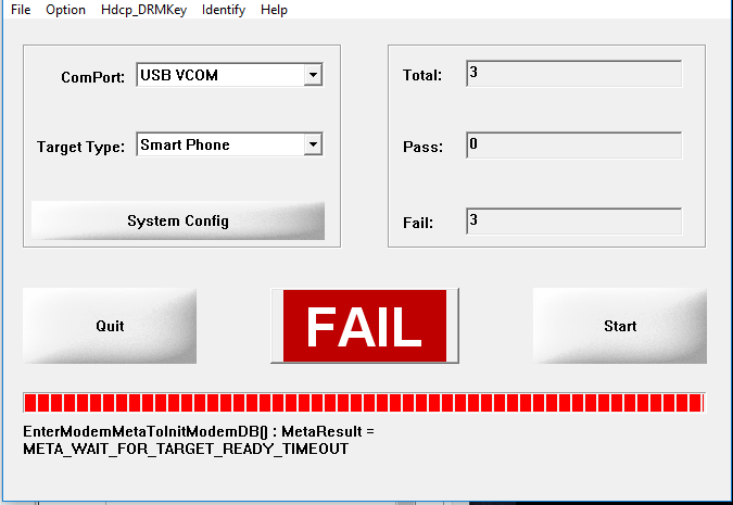

Restoring IMEI GUIDE.
Run SN WRITER
Option TICK
Security USB
Composite Device
Comport: USB VCOM
Target Type Smart Phone
System Config
Only tick IMEI
Dual Imei
Data Base File (This is included in your ROM directory)
MD1_DB MDDB_InfoCustomAppSrcP_MT6755_S00_MOLY_LR11_W1539_MD_MP_V10
AP_DB APDB_MT6755_S01_alps-mp-m0.mp7_W16.04
These files are located at your ROM directory
Hit Save
Hit Start and insert your IMEI and press Ok
IMEI Random Sample
While the phone battery is unplugged from the connector press Volume - and plug to your Usb port.
Connect the battery connector while you continue to press Volume - and wait for the handshake until you get a PASS from the SN Writer. Do this till you get a PASS
Plug in your battery connector and boot up your phone.
Congratulations you just revived your DEAD PHONE and now with working IMEI.

hago todos los pasos y me sale error ..

I can not find the files MDDB_InfoCustomAppSrcP_MT6755_S00_MOLY_LR11_W1539_MD_MP_V10 and APDB_MT6755_S01_alps-mp-m0.mp7_W16.04.
Where I find these files
Re: HARD BRICKED + IMEI REPAIR + DOWNGRADE + TWRP + Root Tutorial
Thu Nov 23, 2017 3:21 pm
They are included in your ROM directory. End of the file name my be different in other roms.
