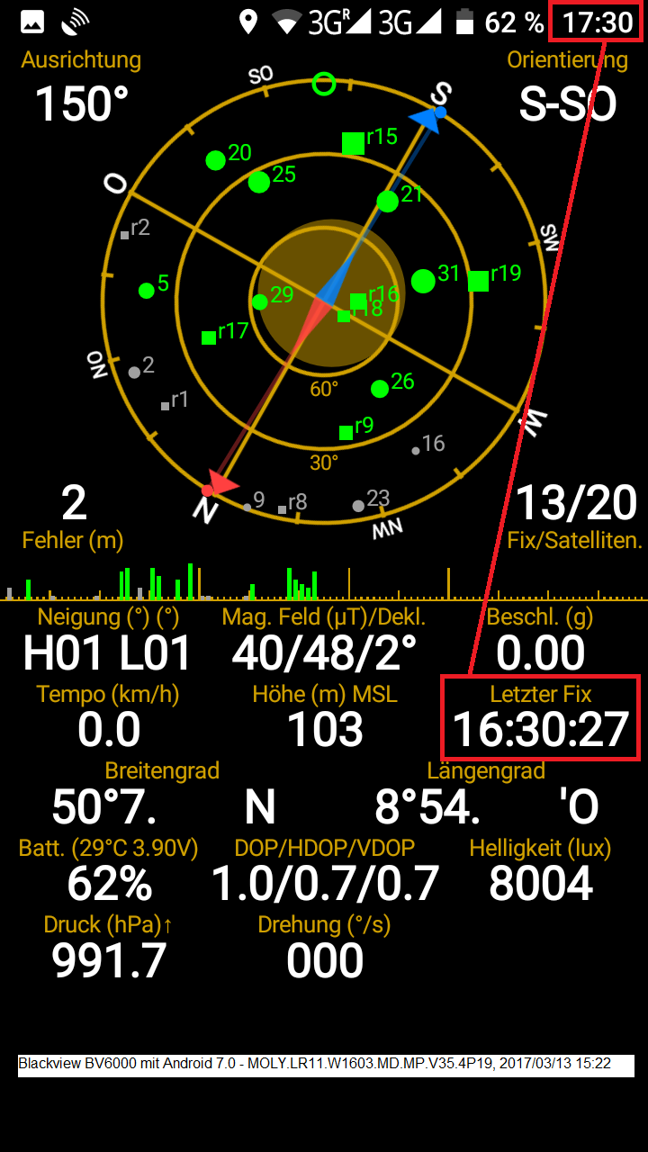

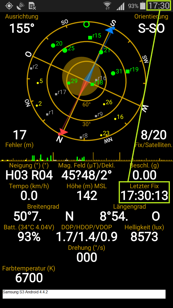

Hello,
The problem is that the time stamp in the GPS record is 1 hour back.
I've matched it with the app GPS status and my Samsung S3. You can see clearly that the GPS time is 1 hour behind the time of the smartphone with the BV6000. With the S3 there is no deviation.
I found the post with you: viewtopic.php?f=144&t=125904
However, a factory reset did not help me.
I think it is now a mistake in the BV6000 together with Adroid 7.0
Can someone help me?
greeting
Mario
[img]
[/img]
GPS-Time Samsung S3.png (218.87 KiB) Viewed 4059 times
GPS-Time BV6000.png (184.44 KiB) Viewed 4059 times

Fri May 12, 2017 8:02 am
Hello, I just saw that it is the same for me.
