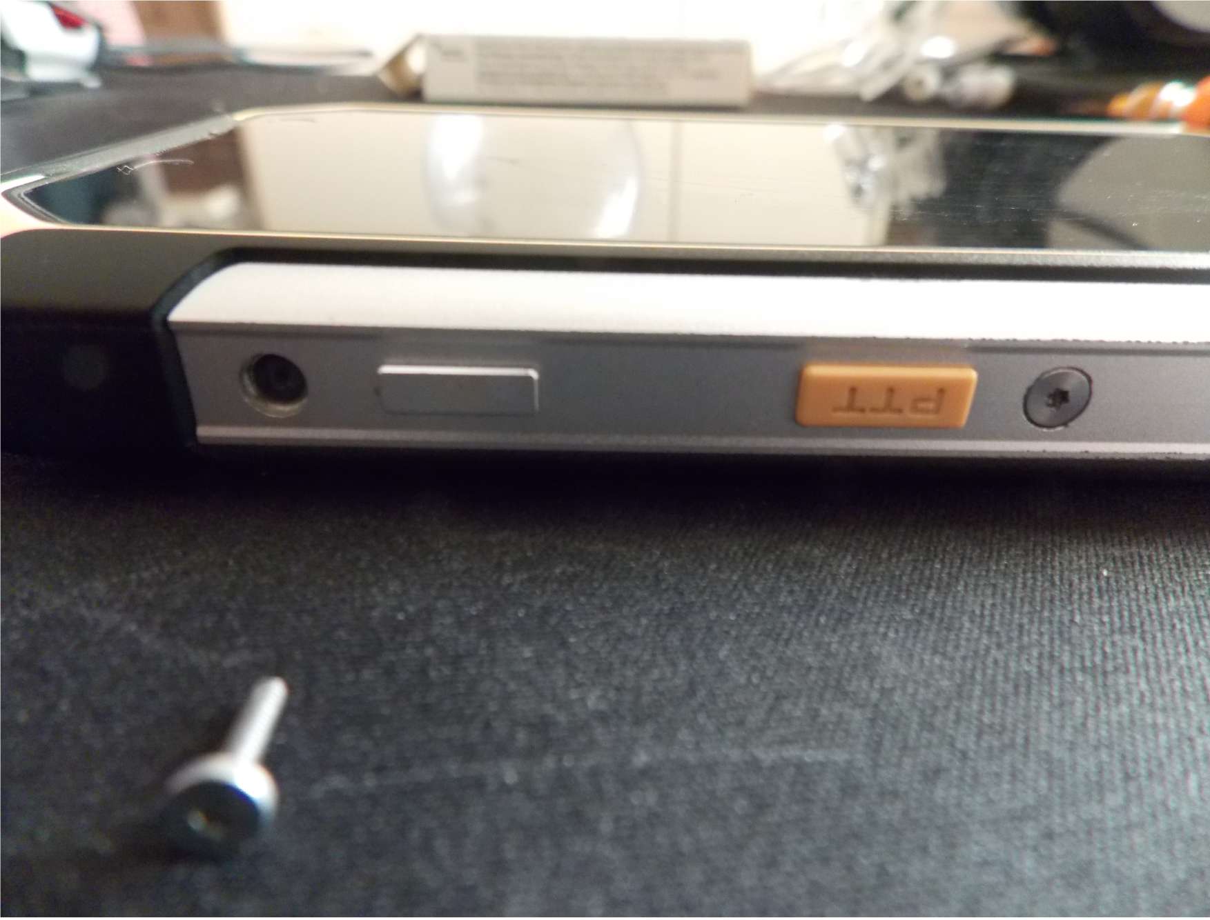

the top left side screw got magnetized FOR SOME REASON and by removing the screw everything works perfect getting the screw near the hole drives the compass back to not working now i just want new side screws
Yes, you are right.
The screws are magnetical and thats the problem with gyroscope.
If you are look on the screws, it's the top right screw.
If the screw fails, the gyroscope works much better.
Thanks.

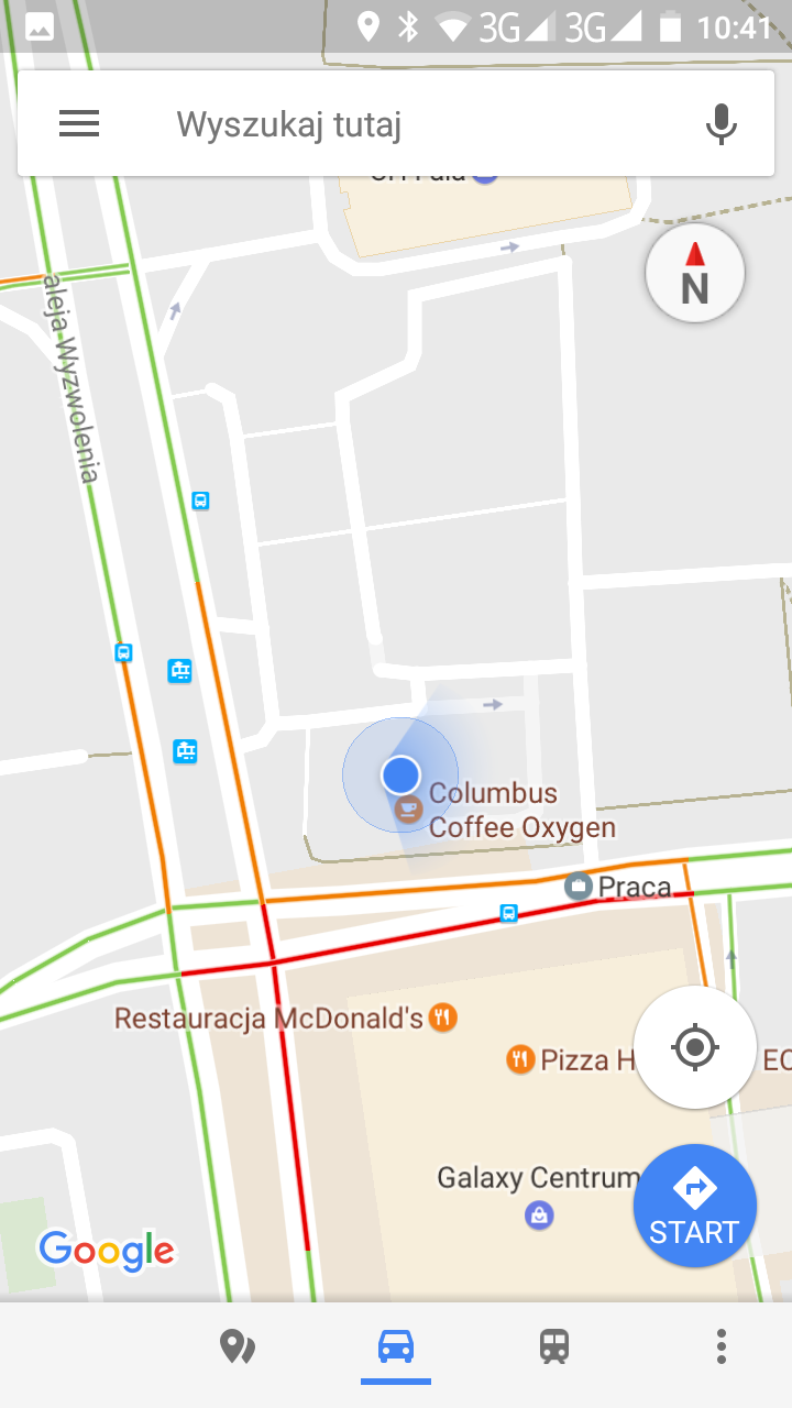

For me this didn't work. I removed all screws and didn't see the difference. Here is what the compass showed while top edge of the phone pointed north:
The phone's top points the north

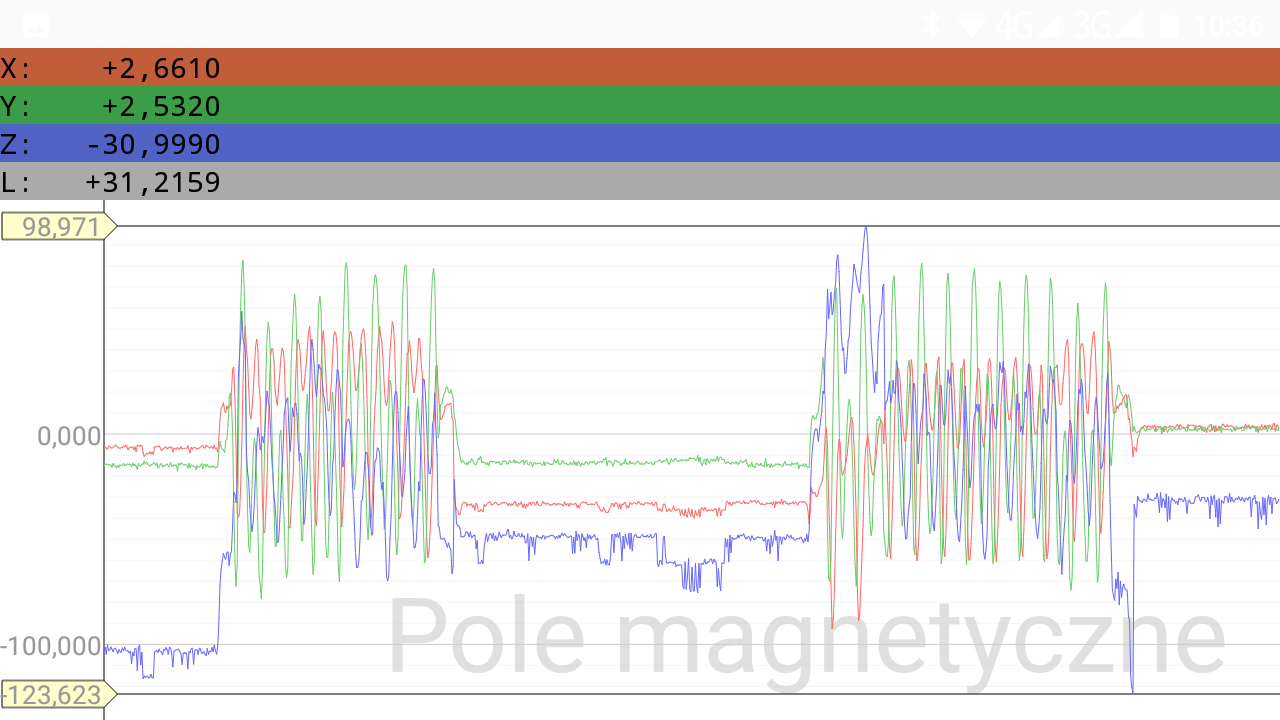

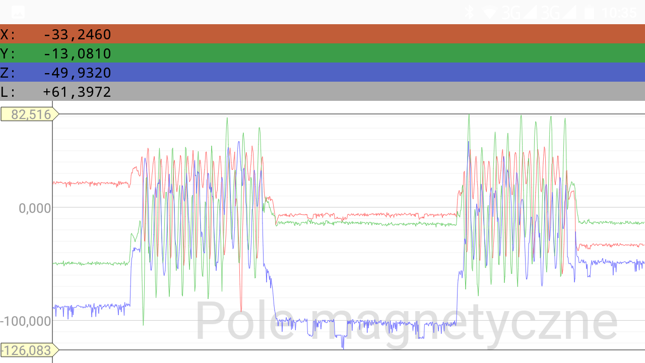

Google maps as well as the compass application complained about low accuracy. But calibration is erratic:
Two 8-path calibrations

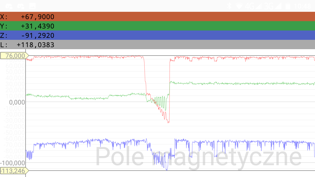

Here are magnetometer readouts without, while winding the screw (large drop on X axis caused ba the screwdriver), and after I took the screwdriver away. Disturbances on the Z axis are maybe slightly larger with the screw but the difference is not significant:
Winding screw in
And there is nothing about the gyroscope. The gyroscope is electromechanical (MEMS) sensor, not sensitive to weak magnetic fields. It looses calibration over time (I have once calibrated the zero point to +/- 0.003 and found today drift of -0.03) but low drift may be tolerated by the compass application.

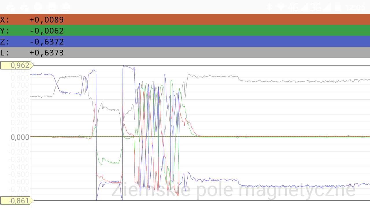

Above are raw readings from magnetic sensor. There is also geomagnetic sensor that serves trigonometric function based on these values.
Geomagnetic sensor
I'ts readings are also a bit unstable. This confuses compass and maps.

I had a problem with the compass: got the error message "accuracy low, please recalibrate". I'd recalibrate, and the message "calibration successful" would immediately (within a second or so) be followed by "accuracy low, please recalibrate". I found this thread... maybe something magnetic near the sensor was disturbing the reading?
I took a compass, the real kind with a needle, and moved it around the phone. There was one screw which attracted one end of the compass and repelled the other. I removed the screw, demagnetized it, replaced it, and the compass now calibrates and keeps its calibration.
This screw was not where the one in the photo above shows it, but one holding the back on. Beware that many small screwdrivers are magnetized to help hold the screw in place during installation: using these will re-magnetize the screw.
