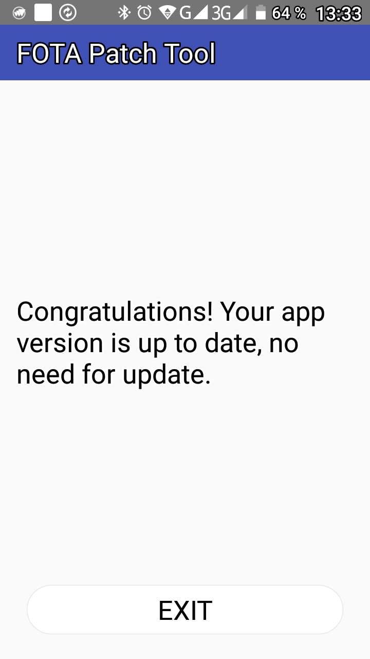

The patch for FOTA is availible at the distrubutor:
http://www.adups.com/article/show_article.php?id=168
No, not really: you can download a patch tool on this website, but when you open this and click "check" you only get the message "retry later" because there is no patch available over that app. When I am right the issue is fixed in blackviews version 20161223 and later but that's not stable for me. Would be nice to get a working fix as long there is no stable new Android 7 Version for all devices.
