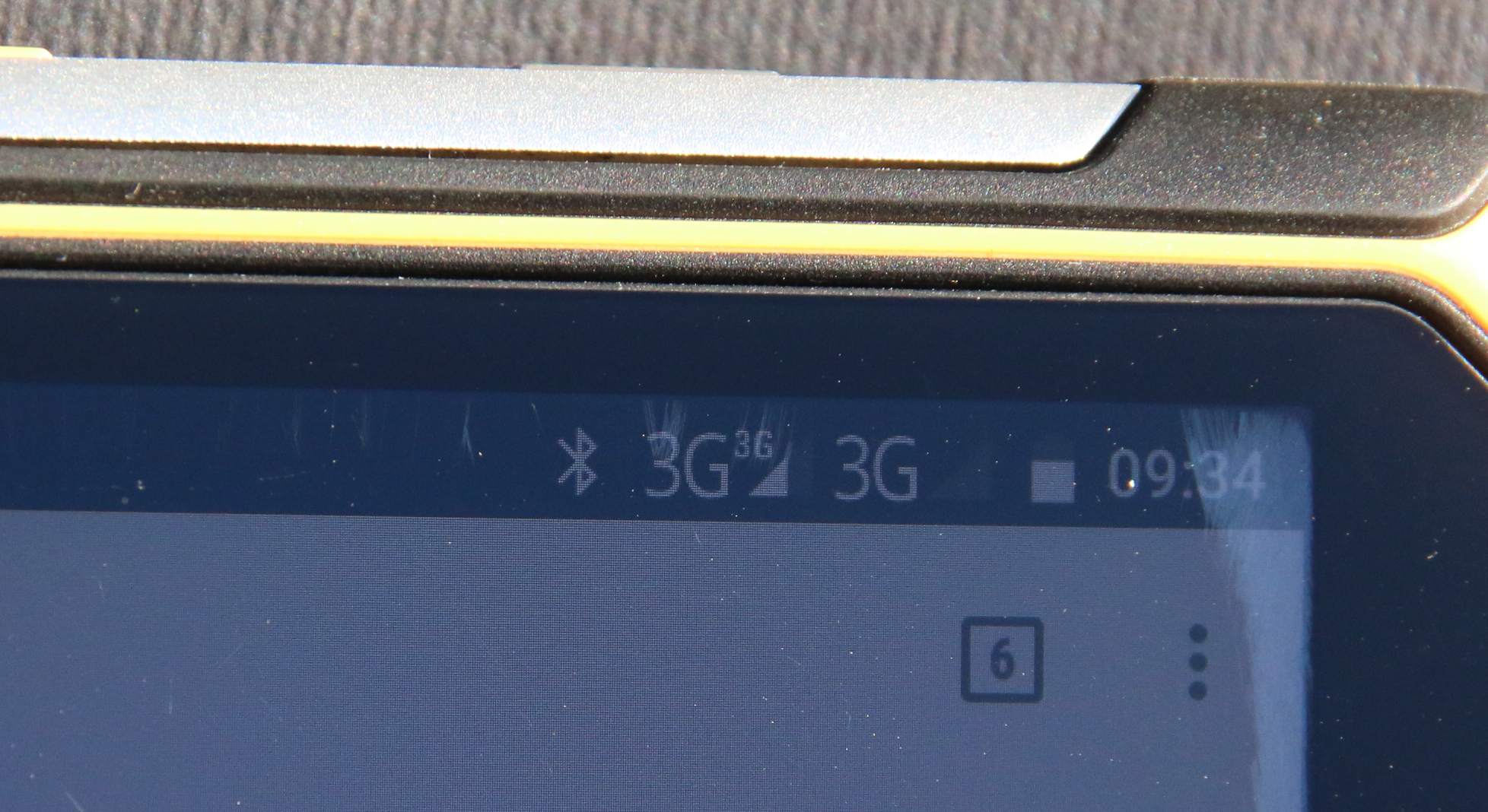

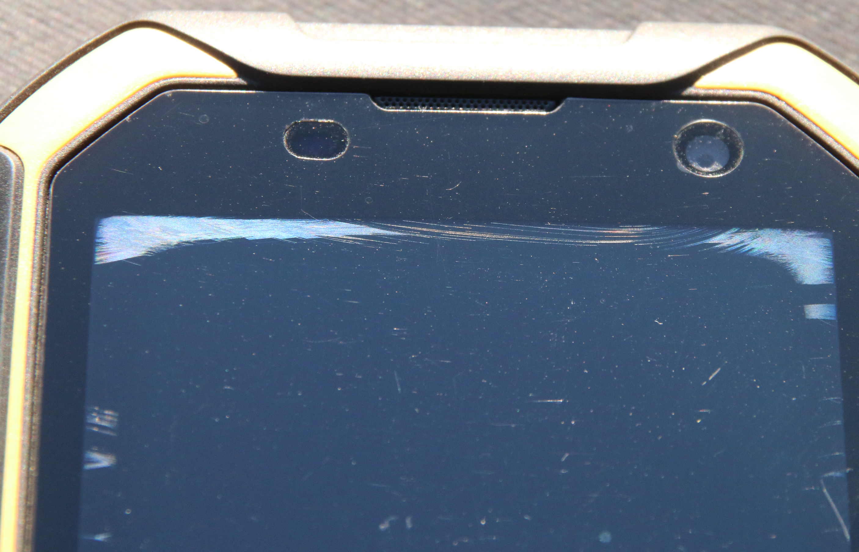

I,m not sure if this phnomenon is related to battery but surely it's not water deposit on the inner surface of the glass (these are pictures of high resolution - please zoom to see more details):
Crystal like structures deposits in the corners and edges of the screen.
Screen's still working.
Screen displays image normally, touch surface works fine. This 'thing' is translucent. Does not occlude the image but is visible in external light. The photo has been made in sunlight when it's the most apparent.
It started with just few strokes in the upper left corner (holding the phone vertically) but it grows every day. What can it be? Judging by the rainbow shine these are tiny crystals of size of 1 nm and less - but where they come from?
