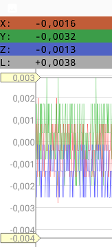

by Tomator
blackview_admin wrote:
call *#87#
Hope this will help.
Indeed. Now the Gyroscope at rest shows +/- 0.003 rad/s.
Gyro reading after calibration
That's very good accuracy. Thank you very much help!
