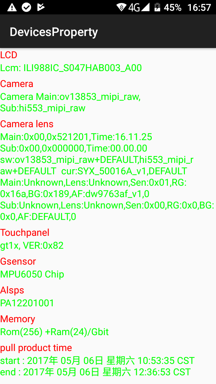

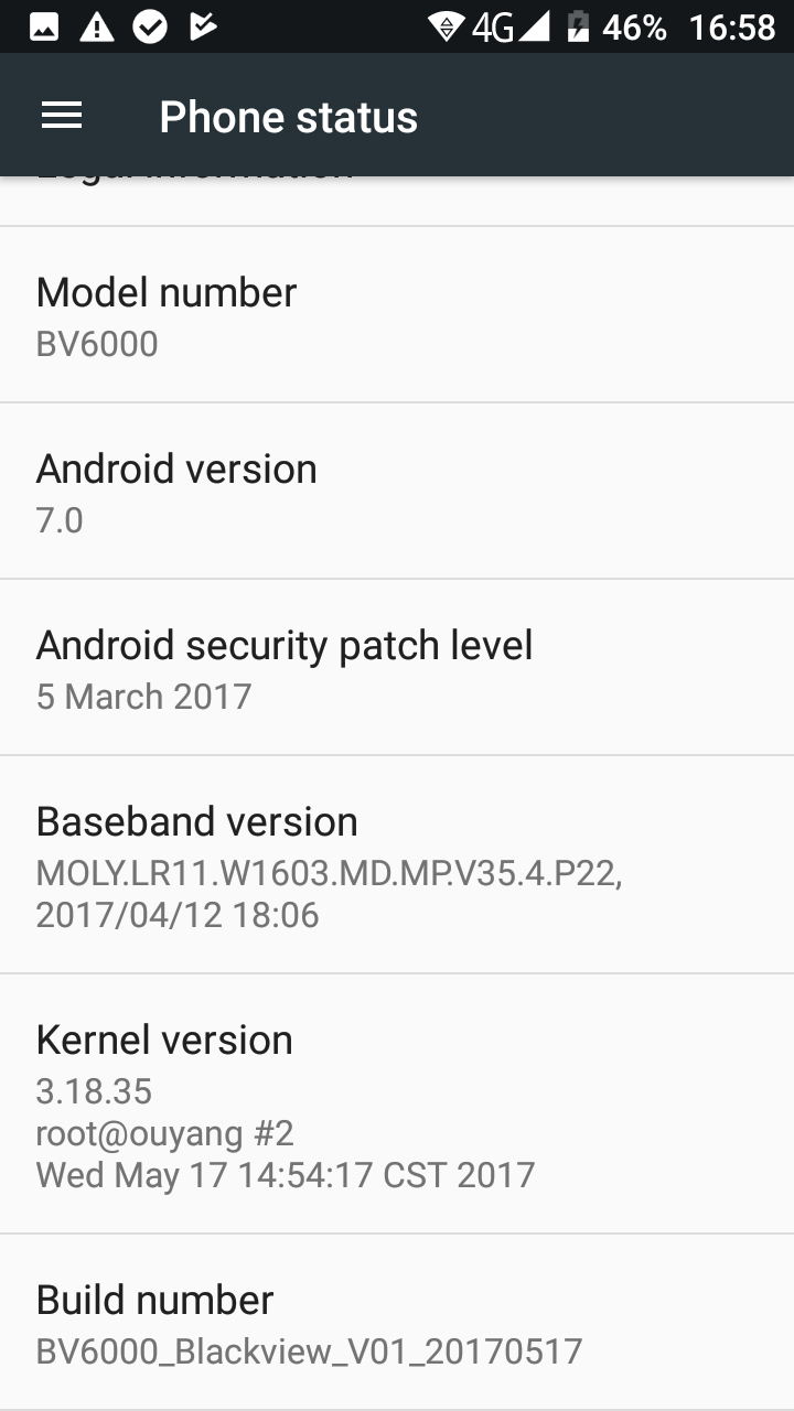

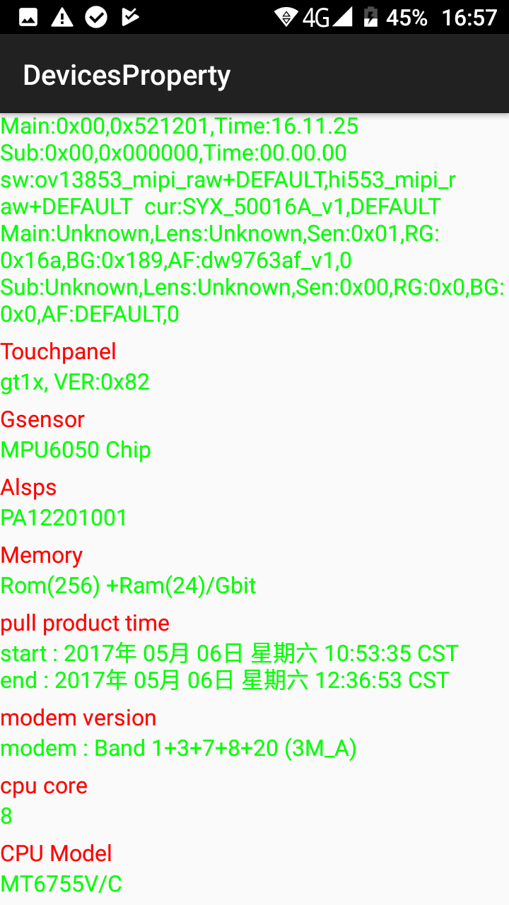

blackview_admin wrote:
"In the dial interface, please type the *#*#114#*#* while enter into another interface, please send us the screenshot.
We will figure out the problem and find the solution."
Image Image Image

Re: Issues after update 20170517
Thu Jun 22, 2017 7:07 am
Hi There.. Screenshots below.
Are you able to indicate whether your team is any closer to resolving the capacitive buttons going to sleep issue?
The only problem I'm having is that the Capacitive buttons (Menu / Home / Back) buttons keep going to sleep and I have to hit them ten times to get them to wake up if I don't touch the phone for a few seconds.

LEDs are driven with one output while the buttons are tied to the input. The input comes from digitizer - so buttons and LEDs are controlled by two different processors. The issue doesn't occur with GT9XX_GESTURE chips while does with gt1x. And you might be close to the truth: when LEDs go off, the digitizer may be switched to low energy mode. Probably gt1 sleeps more deeply that GT9? We'll never know. But I wish you all the patch will come soon.

The issue doesn't occur with GT9XX_GESTURE chips, nor with FT5406_MT Touchpanel
