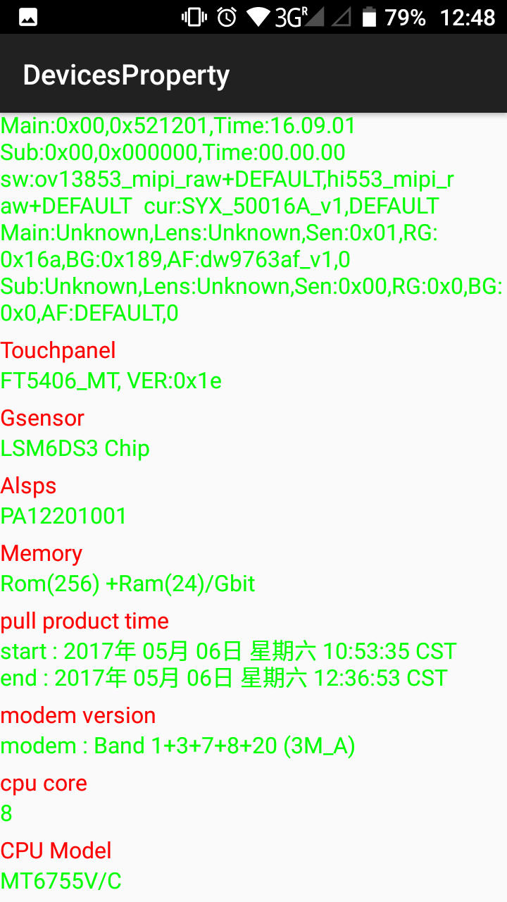

BeHa wrote:
In my case the phone hangs for a moment when I touch the screen sometimes. In update 20170414 everything with touch screen was ok but now system is lagging when I touch screen. When I touch and press my finger for a long time when system is hang up, phone will restart itself. :(
"In the dial interface, please type the *#*#114#*#* while enter into another interface, please send us the screenshot.
We will figure out the problem and find the solution."

Re: Issues after update 20170517
Tue Jun 06, 2017 10:49 am
Screenshots:

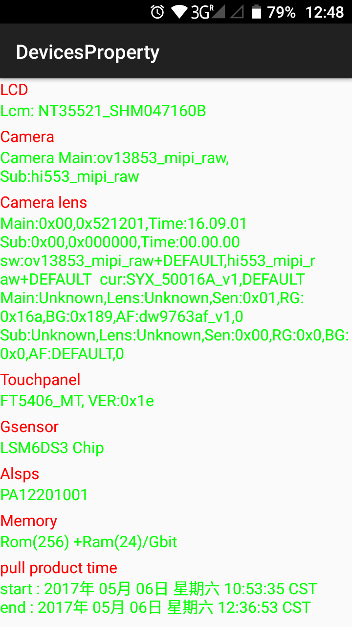

Wed Jun 07, 2017 1:55 am
Something definitely wrong with the touchscreen driver after the last update. If you keep your finger on the screen for about 1 minute, the phone will reboot.
Attached my device info.

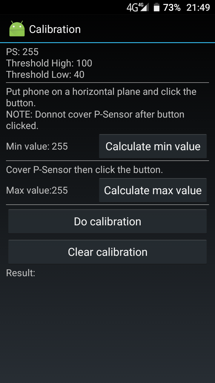

First, I'm happy I brought my BV6000 to life again. I've replaced the front panel and the battery. Screen works fine, touch works fine. I made a firs test call and didn't notice any problem during this call, I was able to see the screen turns black when the phone was by my ear. But I updated software to 20170517 and now the proximity sensor does not work.
I read this topic and typed *#9646633# code. The sensor reads constantly 255 regardless if the phone is lit, touched, charging or not. The calibration fails then as well as test in *#87#.
*#9646633# calibration

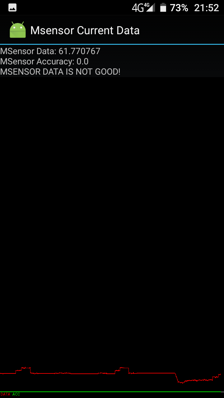

I've also looked at the MSensor, finding that the data isn't good but, to be honest, I don't know what the MSensor is and what these readouts mean:
MSensor
