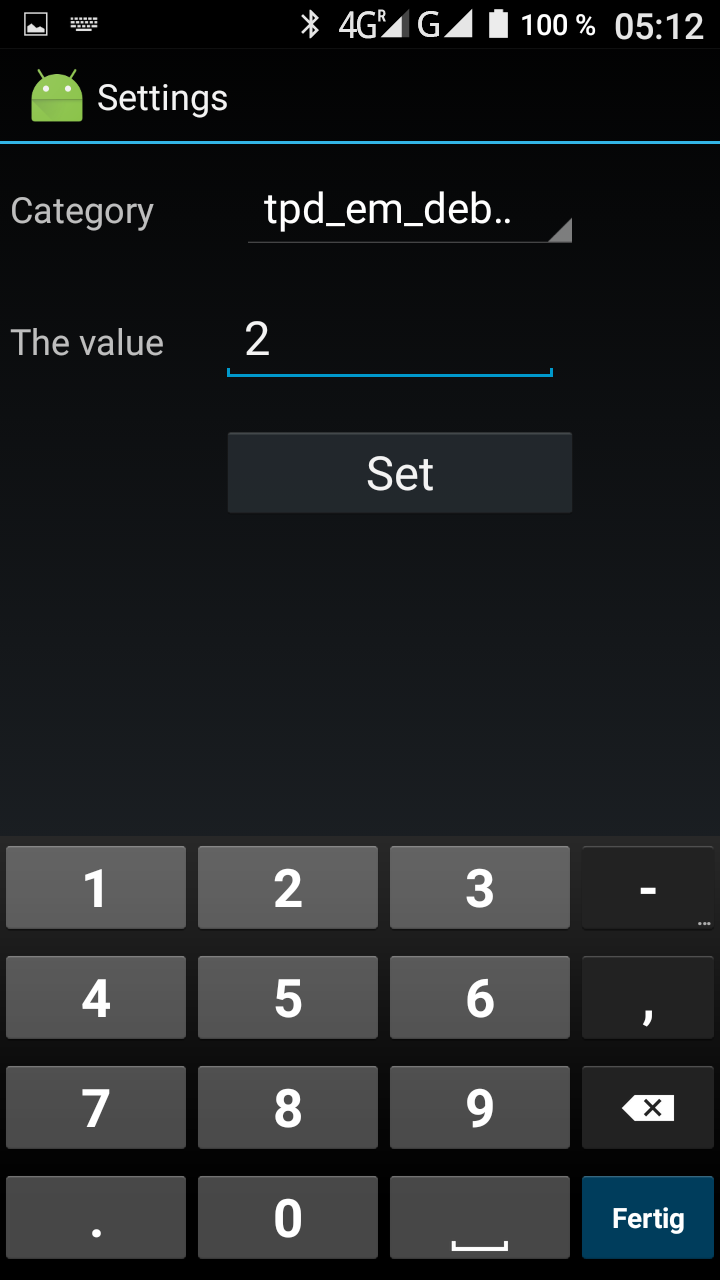

*#*#3646633#*#* go to touch screen settings then go to "tpd_em_debounce_time1" change the value to 2
touch
It works only for a short time and the Setting goes back to the old value...

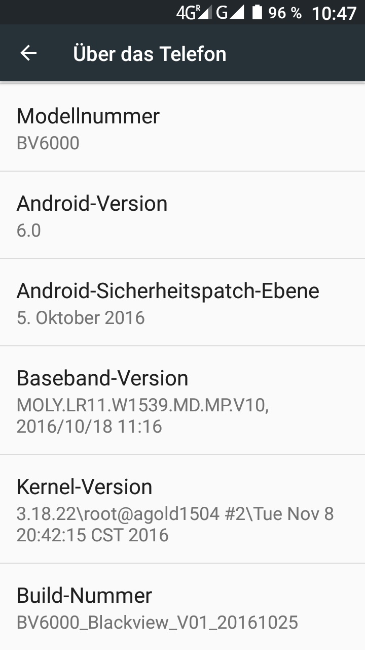

hjz6481
Posts: 2
Joined: Wed Jul 26, 2017 3:18 am
Re: Problem with touch screen
Fri Jul 28, 2017 8:51 am
sorry this is my konfiguration
