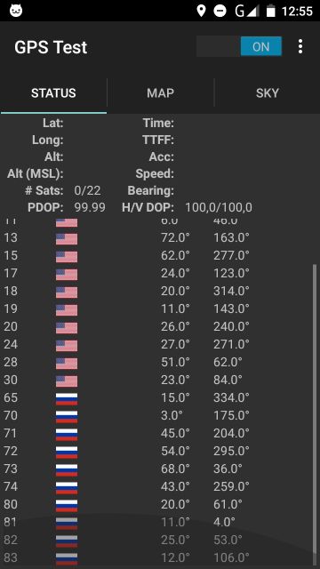

Hi, i am from Berlin Germoney.
For my GPS-Test i use the app "GPSTest" from "barbeauDev".
The only change is in settings "Use GNSS APIs".
old GPSListener:
here are GPS 1 - 30 , GloNaSS 65 - 83
new GNSS APIs:
here are identical numbers
look at numbers 10,17,18 and 19.
You understand what I mean?
