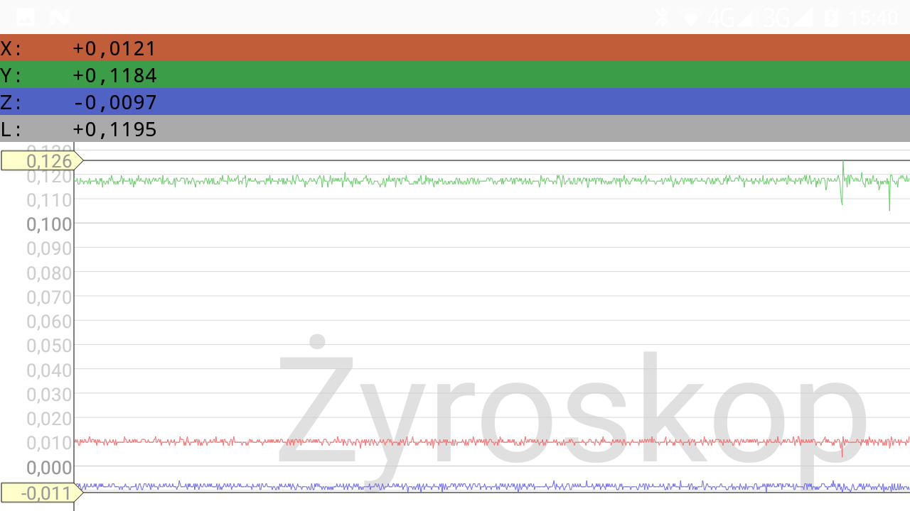

After the last update I can see the gyroscope is still not calibrated and in options is no calibration for gyroscope (but is for proximity and acceleration sensors)
Gyroscope readings
This sensor should be reported as uncalibrated gyroscope sensor by the system due to significant drift on axis Y (in my case). This causes the phone has 'impression' of being slowly rotated to the right. The gyroscope at rest should read all zeroes (Eath's rotation of 2.31e-5 rad/s is out of the sensor's resolution) plus some noise that can be suppressed by low-pass filter.

The geomagnetic sensor is (probalby) placed too close to the power line. Electromagnetic field from the conductor may magnetize the sensor also changin its reading over time. This makes calibration and compass useless.
On the other hand, the gyroscope behaves stable. It's at-rest readings, although too far from zero to be acceptable, is always the same and might be easily compensated. The 'gyroscope uncalibrated' should show what the gyroscope does plus (in my case) drift of (x: 0.01, y: 0.12, z: 0.01). This drift, subtracted, would give valid at-rest readings for 'gyroscope'. The sensor may by cheap and show inaccurate movement readings but this wouldn't be as annoying as wrong zero point.

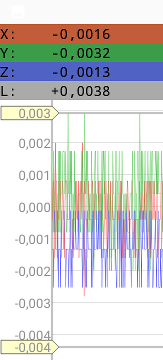

Tue Mar 21, 2017 8:47 am
blackview_admin wrote:
call *#87#
Hope this will help.
Indeed. Now the Gyroscope at rest shows +/- 0.003 rad/s.
Gyro reading after calibration
That's very good accuracy. Thank you very much help!
