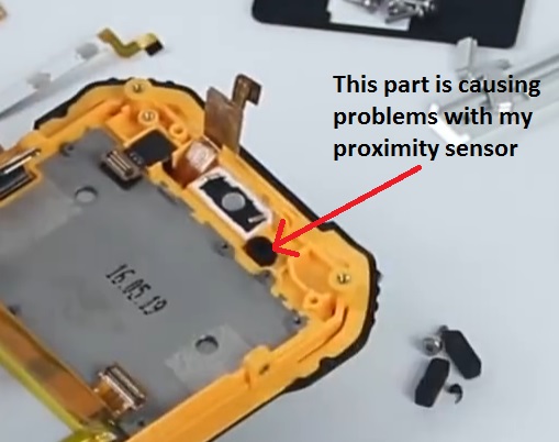

Video comparing working BV6000 and broken BV6000 proximity sensors:
https://www.youtube.com/watch?v=s8NYcs-Yo5E
Root cause:
Proximity sensor is good. Rubber part covering sensor is really poor quality and it has a gap just above sensor causing light leaks.
Workaround:
Disassemble the phone. If you turn upside down this rubber part covering proximity, then proximity range changes from 0-80 to 0-200. It is not 0-255 as it supposed to be but it is much better.?
The only solution:
New working rubber part to be sent to all affected users.
