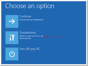

1. Press Windows Start menu button. Click “Restart” from the power options menu or
the Start menu and hold down the “Shift” key at the same time.

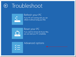

2. When the computer starts up click Troubleshoot

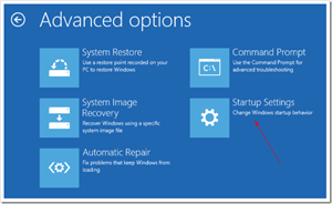

4. From the next menu select Startup Settings

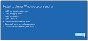

5. Then press Restart
刷机5 - 副本.png (12.9 KiB) Viewed 5605 times

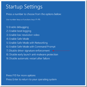

6. The screen displayed allows you to “Disable driver signature enforcement” by pressing key F7
刷机6 - 副本.png (38.44 KiB) Viewed 5605 times
Wait for the computer load the desktop and thats all. Driver Signature Verification is disabled for this Windows boot.

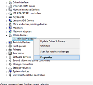

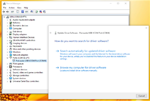

3. Connect to a computer USB cable off the smartphone and immediately close look at the Device Manager. Once there appears a new connected device called MT65xx Preloader, do a right click on the device and choose to update the driver, and then search for the driver on the computer, then the “Browse my computer for driver software” button and specify the path where we unpacked our driver (extracted from the archive folder where the .inf files - All MTK USB Driver 2014\All MTK Drivers\New inst. win 7&8x64)
刷机8 - 副本.png (42.9 KiB) Viewed 5605 times
刷机9 - 副本.png (41.37 KiB) Viewed 5605 times

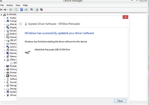

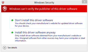

4. Click Install this driver software anyway and the installation will continue
刷机10 - 副本.png (31.13 KiB) Viewed 5605 times
刷机11 - 副本.png (24.62 KiB) Viewed 5605 times

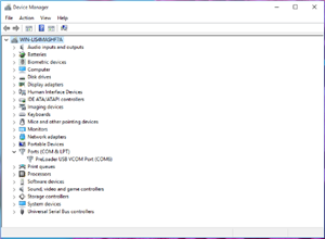

5. After installing the driver, it is desirable to restart the PC. If the driver installation was
successful now when you connect your smartphone for a short while in the Device Manager
in the section COM and LPT ports the device USB VCOM will appear.

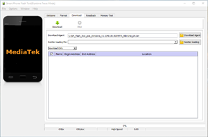

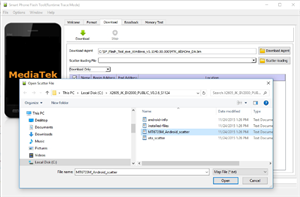

4.In the opened window, click the Scatter-loading (on the right side of the application). File explorer window appears, go to the folder with the unpacked firmware and select the file MT6735M_Android_Scatter.txt :
刷机14 - 副本.png (31 KiB) Viewed 5605 times

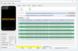

5. After selecting the desired Scatter-file the program will load all the data about the firmware and its components in the form of a table. Make sure that the Flash Tool automatically checked all the files for the firmware:
6. If all files are checked just click the Download button in the Flash Tool and the tool is in Standby mode. Flash Tool waiting for cable connection.
刷机15 - 副本.png (54.31 KiB) Viewed 5605 times
7. Turn off the smartphone. Connect your phone to a computer via a USB cable, and in a couple of seconds (if the driver has been installed properly) Flash Tool will start the firmware flashing process.

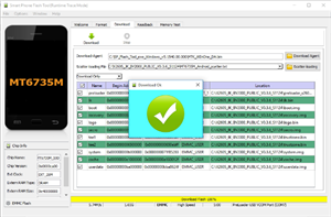

8. Wait until the process of firmware downloading will end (small window with a check mark in a green circle in the middle will appear). Then disconnect the phone from the computer.
刷机17 - 副本.png (56.32 KiB) Viewed 5605 times
