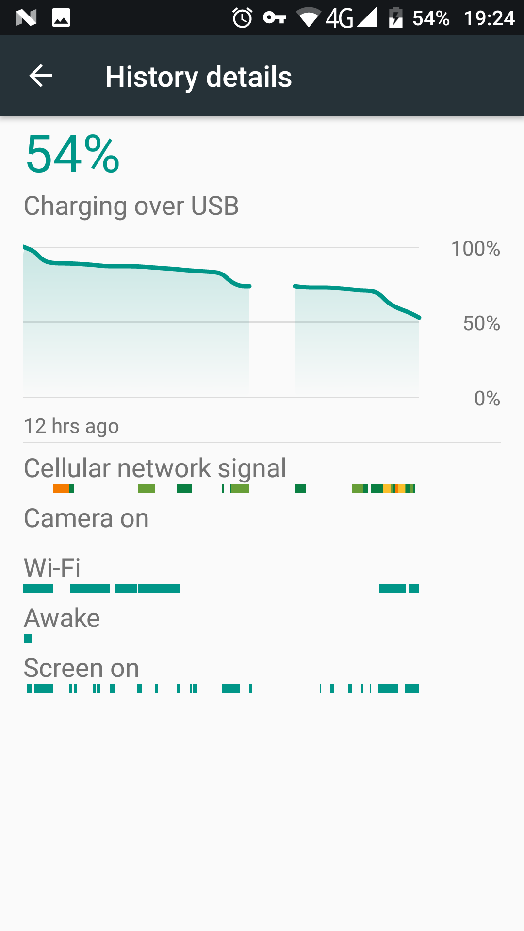

Some other things to report: Last night when I was charging my phone I was playing with the settings and switched the “Performance and power saving” option to “Sports mode” and then back to “Normal mode”. Then this morning I disconnected the phone from the charger and go to work. Today the phone started to enter deep sleep mode. Look at the screenshot.
The “CPU Spy” app is also reporting that the CPU is in “deep sleep” for more than 6 hours during the day. However I am not sure the graphic above is accurate. As you can see I have used my phone a lot of times during the day (the screen turns on and off). I played games, I made photos, I made calls. However the graphic shows that the CPU was not awake during the whole day. Is this possible at all? Also I used the camera a lot of times and it is not shown. Also I do not understand the “gap” a little bit after the middle of the graphic. What is this? I am not turning the phone off and on?
